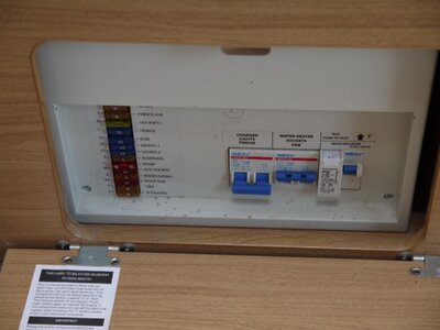

The van is a 2011 Elddis Breeze (Xplore special edition) that I have owned since its first birthday - and this the distribution panel:
Went out to the the van on my driveway the other evening, switched on one 12v ceiling light which was totally dull. The MCBs were both in the off position - RCD in the up/on position. Generally the battery which is 110Ah is left on charge plugged in within my garage- its now nearly 6 years old. In the position in the photo I have mains power to the sockets. However when I switch on the left mcb (fridge, lights, charger) it clicks out immediately and triggers the garage mcb too. Having removed the fuses for the lights and fridge the same occurs so I conclude the charger is causing the trip. I have taken the battery off the van and using an external smart charger the battery is clearly defunct - after a day on charge it reached 11.6v before stating 'Error'. This morning with no load overnight it was at 6.6. Although I don't think relevant the panel by the door Mains/lights/awning light/pump is all switched off.

Just sorting out the caravan and have a problem with the battery or charger.
This indicates the 12V circuit has low voltage.
That concurs with switch settings
This indicates you have a significant current overload, especially if it is tripping the MCB in your garage. The concern is we don't know if its the Charger, fridge or lights. or the 230Vac wiring in the caravan.
Your assumption is incorrect. The fuses you have on the left hand side are only for 12V circuits not the the mains 230V circuits, so the removal of any of the fuses should not affect the 230V systems.
This confirms the Battery is is totally failed.
I'm not familiar with the exact panel you have nor how it is wired up, so I can't confirm your conclusion.

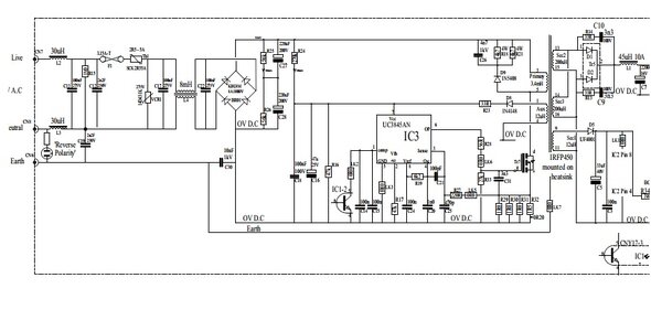

Based on years of experience with caravan battery chargers/PSUs and other similar power supplies the charger has had it. Even charging a dead battery wouldn't cause the charger to trip the MCB. The internal circuitry circuitry has current and voltage monitors and these feed back to the primary switch mode control IC , which even if the output was dragged down and the output current was at maximum this wouldn't draw anywhere near the 40A which would cause a 10A type B MCB to trip in less than 5 seconds . The main cause would be the switch transistor has failed short circuit in the attached photo this is marked as Tr7. In the attached schematic there is a 5A A/S glass fuse which would have popped , but some PSUs dont have an input fuse as the MCBs in caravan are double poled a neutral to earth short may still trip it. Short answer - change the charger module , Sargent do a 20A one:- PX300 or you could get one of the Victron blue smart types.
