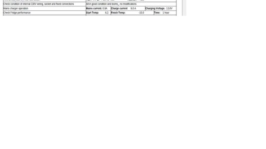

After my last service I was told the battery charger was working but not pushing much juice through. Had I been informed during the service I think I would have asked for a replacement but I missed that boat. The battery is quite new and I wasn't told there were any problems with it and, I presume, its state of charge.

Did your AWS certified service engineer just complete the service form with 'ticks' ( about as much use as a chocolate fireguard)or actually he/she detail what the charging currents and voltages were and if so what was he comparing the 'performance' with? I was taught that when completing service reports or commision /validation sheets that the values measured were to be recorded and ticks were not allowed as it conveyed no information on the result of the test/inspection. Attached is a section of service report which I complete , this allows either me or the next service engineer at the next service to see if the performance or things like the friction pad adjustment have altered since the last inspection.IMO caravan owners should insist on actual values on service sheets ( and that includes cars!) Isee so many caravans that have been service every year ( complete with AWS stickers) and the brakes are way out of adjustment, but the service sheets say ' brakes checked -(tick)
I’ve never had anything like Ian’s description on caravans, just the AWS schedule with ticks, and sometimes notes if something wasn’t okay.

Otherclive, to be fair the report is very comprehensive but it's in the van and at the moment the van is not here. He even mentioned the fact that the screws holds the external gas outlet mount had cracked the plastic - however there's enough sikaflex to be confident nothing will part!

Maybe this is the test my service man made which, since it's only reading a direct charge from the on-board charger (and therefore sidesteps the many factors that can influence the numbers read elsewhere), it has real meaning.
Should the reading be lower than 14.1v by a significant amount then maybe I should worry - but what is that "significant" reading - under 13.8v you say?

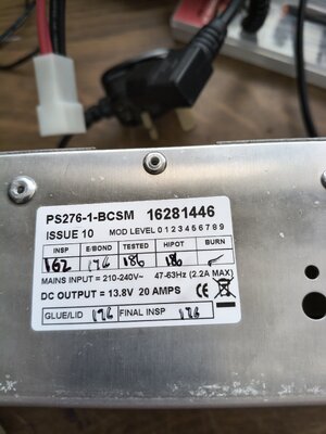

The PS 276 will work as a PSU without a battery fitted. I've repaired quite a few of these over the years and I test the repaired units using a constant current load unit which can sink up to 15A .The PS276 is a single stage power supply and is prone to overheating the internal dummy load ( a 5W resistor or on early model 2x 1W resistors) when there isn't a significant load on it which can, over time can damage the copper tracks on the PCB. On the ones I've repaired,the high voltage storage capacitor or the drive transistor usually have let go, taking out the internal 5A PCB fuse. I modify the units by clamping the load resistor to the side casing and add a thermal switch which activates the cooling fan as well the output current trigger which activates the cooling fan when the output current rises above a set value.
The PS 276 is not listed as being fitted to Swift Caravans although I will check when the van is available.
I must say your technical knowledge is impressive.
@Johnb yes you are correct the PS276 , is fitted in BCA EDU s fitted to Baileys and Coachmans and others , Swifts use Sargent Electrical EDUs which have the PX300 ( now the PX310 in new ones , both are rebadged meanwell units) PSU in them and older ones had the charger pcb built into the PSU 20XX series EDU, and before that I think they used Nordelettronica units. One day I might compile a list what caravan and year had what systems in , but for now I just repair them as they come along ,although recently I have started fitting a NPB360-12-TB as replacements.
