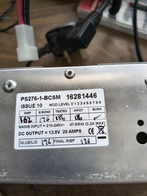

Lots of caravans are fitted with things that are called chargers but are not. They are just fixed voltage PSU delivering 13.5V /13.8V this will keep the battery topped up and allow items in the van to run but won't even get close to fully charging the battery.
Another thought unless you have just turned a smart charger on then it may well have dropped back to float
What I am trying to say is don't be surprised with the "charger" on if it's only reading 13.5V

The OP hasn't given the age, make and model of their caravan - caravans changed from up to 13.8v power supplies to up to 14.4v smart chargers some time between 2001 and 2013, going by my caravans, so it's only older caravans that will have power supplies rather than smart chargers.
I'm afraid that isn't always the case certainly not for Elddis.
If you have a charger you normally can't use it without a battery fitted.
My 2017 Affinity 554 was fitted with a 13.8vPSU as I suspect many are. Just picked it out of the bin checked the voltage
13.785V.
That's why I fitted a Victron charger/PSU
