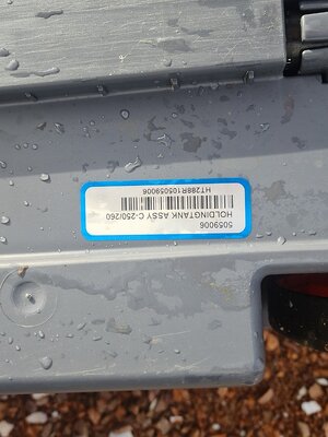

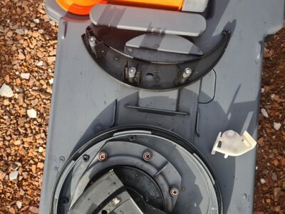

Good Morning all, yesterday we had visitors to the van and my relative teenager told me she couldnt close the toilet🤷‍♂️ I could be totaly wrong but i feel she jammed it with toilet roll and forced the door closed.
Can anyone point me in the directon of a supplier please.

Sorry for poor photos, i notice on ebay these are available made by Candzton ? There is also chinease manufactured ones but i will keep clear of those, is Candston made units ok?

Seeing how the mounting pillars are snapped off, I think the easiest thing to do is buy a complete replacement holding tank.They should be available from a reputable dealer,seems strange that they broke as they have, suggests a certain amount of force may have been used.

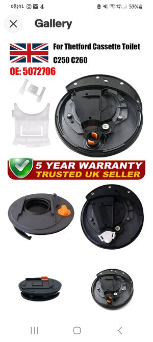

Cheers woodsieboy,looks like these are part of the replacement mechanisim, see pic i may be wrong but looks like i can buy this part and keep my tank.

Yes I think you are right,,you need to replace the round part that screws in to the tank,but my thinking was at the cost to replace the part it was worth going the whole hog.Regarding the replacement I would always go with the genuine Thetford replacement part,worth looking on you tube as there a good how to videos.
