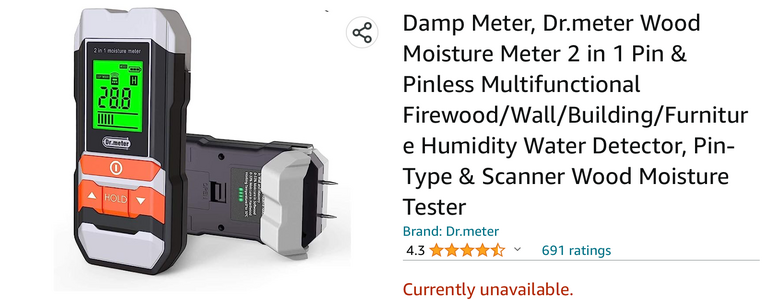

Get a moisture meter and keep testing regularly. I would recommend a combination, pin and pinless one.
I bought this one which is really good, but not available right now.

Hi John thanks, I have a damp meter, the damp has been sorted.
It’s the marks that I’d like to remove which appeared while the damp was occurring before.
