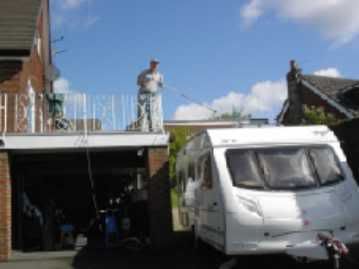

Well said Val.
Here is another with back problems which went again whilst at Englethwaite Hall a few weeks ago. It caused us to miss Park Coppice but another week at Englethwaite wasn't to be moaned about, one of our favourite sites.
Also I can reverse the van but not to get it spot on, marker to the centre of the van, so the mover helps with not having to push the van and do my back in. I look at it as a kind of insurance.
Another point is I need a mover to keep my van at home on my drive which slopes downhill at a diagonal. The drive is close to a wall but with the mover I can park it first time inch perfect. I also pitch it A-frame first to deter thieves.
I must add that I've never had to use the mover yet when hitching up onsite.
The mover is the best thing we've bought for the caravan and is worth every penny. We bought a PowrTouch after the many, many favourable comments on this forum and after having problems with the Truma we had before.
Without it I couldn't keep my caravan at home. I suppose it's the macho coming out that says they don't ever need one
