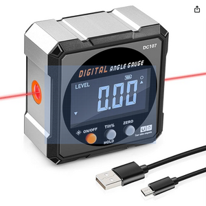

The device is shown below. Each of the edge faces is magnetic and the instructions say to calibrate each face in turn.Screenshot 2025-01-23 at 12-16-24 Digital Angle Finder 2 in 1 Laser Angle Gauge Level Box with...png

When placing the unit on a flat surface, take a reading . Then rotate the unit so it is facing 180 ⁰ and take another reading. If there is no difference in the reading then the surface is level.
That will certainly check that the instrument is reading true. But not actually calibrate. Presumable then pressing zero on a known true surface calibrates.

cut a bit of wood, use square to see if its square, then put your doda on square cut, simples.
The virtual coconut goes to Hutch although this gets you to a horizontal surface. From that you could then use it to calibrate a conventional spirit level if the vial is capable of being adjusted. In the case of a Digital Spirit Level there would have to be a similar method to adjust it to the correct setting.
Most DIY vial based spirit levels I've come across don't have any capability of adjusting the vial. Also they are a bit crude in terms of accuracy as you need to 'eyeball' the bubble positon.
In the case of my Digital Inclinometer and re-readiing the manual with a more powerful microscope its calibrated to an absolute horizontal in the factory. If you need to do it again then the only way is with a calibrated absolute horizontal surface.
