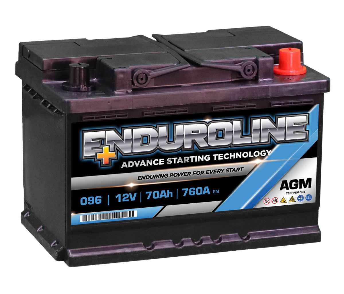

The original battery is supposed to have been a "Mopar" battery or probably a rebranded Bosch, Varta or Exide battery for Chrysler. They are definitely not worth +£500 before cost of fitting. The equivalent Bosch, Varta or Yuasa AGM battery is under £200 including fitting.
When it gets a bit warmer I will disconnect the aux battery from the main battery and measure it across the terminals. I am not sure how the aux battery is connected to the main battery, but assume that it is a simple plug in.

I don't want to buy a battery until I know the age of the current battery. Plus at this point I do not know which battery is causing the issue.

I am still no nearer to determining the age of the current Bosch AGM SS battery in the Jeep.

The link below is supposed to help you identify the origins of a Varta or Bosch battery.
How about e mailing your photo to Bosch and ask them ?

Thanks I have tried just about every link and the end result did not make sense which is why I have been asking around on various forums, but no one seems to know for the Bosch battery. Unfortunately not the easiest battery to remove from under the seat to check for any other markings.

Looking at the Q code on yours
B 22 08 110 3J7
B = made in Spain
22= ??
A = 2018
08= August
110= Day ie 11th
3J7 = battery model serial number
All according to a Russian Bosch site😎

Thanks Dusty as I had similar for the year, but thought I got it wrong as the car was built in 2017 and normally the vehicle gets the Mopar battery which is a rebranded battery. However being the EU maybe the Bosch is the original battery.

If it's a 2017 car with a 2022 battery of different make to OE fitment, it's reasonable to assume that it was replaced at 5 years old but raises the question why the new battery needs replacing after just 2 years, a Bosch AGM is normally high quality.

According to the build sheet or VIN the car was manufactured in late 2017 although only registered in March 2018. We have had the vehicle since Aug 2022 and in that space of time we have not even done 10000 miles with the vehicle. It is mainly used for towing and long distance trips as we use the Corolla around town.
You are correct about the Bosch being a good quality battery and should last at least 4 -6 years even with Stop Start technology. Most times the Stop Start is switched off as even less drain on the battery.
