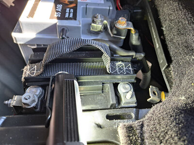

Finally got enough nerve to remove the negative on the aux battery and then measure voltage on both AGM batteries. The vehicle had been standing for nearly 24 hours.
Main battery exactly 12v and the aux battery 12.1v. I gather that both the batteries should be at least 12.6v and need replacing?
However as per the negative terminal on the right I have never seen a battery with this type of terminal as the terminal looks to be square with a screw type rod in it. I am not sure if that screw needs to be removed to be fitted to a new battery as the only other ones I can find seem to have a square terminal for 12v 14ah 200A AGM auxiliary battery.
Please advise. Thanks.
No necessarily, what you are seeing is only indicating neither is any where near fully charged.
Even batteries that are losing their ability to hold much charge, can still exhibit 12.7, 12.6 volts if they are nearing fully charged.
Note this is hold as much energy as they now can hold, which could be way different to holding what amount of energy, they might once have been capable of holding.[The true Ah capacity being indicative of a quantity of energy]
As you are being told, you need somebody competent to check the "health" of your batteries, plus the health of their charging systems; just taking voltage readings yield less than the required information to know what the extent of your problems are.
Edit: IMO you are more likely to find "competence" in this area with a well respected auto electrician, than in many car brand dealerships! That's the area they work in, not just one facet of a much wider range of issues.
I would look at the numbers on both batteries, go online and price new ones. Then replace, taking the seat out is probably the hard part. And it looks like you have done that. The terminals will then be like for like.
Only problem might be, if your car needs some coding done. So probably best to have an auto electrician do it. This can be how some garages and particularly main dealers get to charge over the odds. Short and curlies come to mind.

Can someone please comment on the small screw type post on the negative of the battery? It is obviously a fitment, but not sure if it is supplied with the battery on not?
As an after thought regarding the battery, initially I thought there was only one battery in the vehicle. When I found out there were two batteries even then I suspected only one of the batteries being an issue.
I am fairly sure I could managed if it was just the aux battery, however I have had conflicting advice that I may lose settings in the vehicle if the battery was disconnected unless I had a Memory type unit that holds the memory, I decided to abandoned that train of thought. If it happens at the fitter, it is their issue to resolve the issue.
