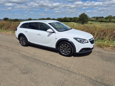

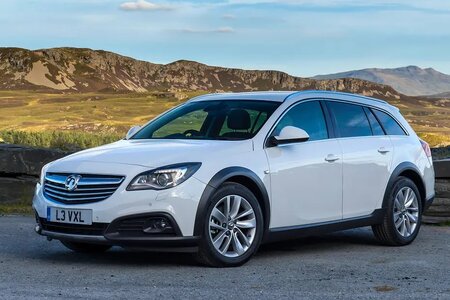

HI Just bought my first 4x4. Bit different to the Sport Tourer bigger ground clearance, drive train etc. Any advise on tyres servicing. Not the one in the pic but same trim. Mines Glacier White, You need sun glasses to look at it when the sun shines. 2 0L Diesel 163 hp 350nm toque. 1900 towing limit.

Lovely car Dave, it will look great with your van on the back.

Looks nice, I didn't know Vauxhall did a 4x4 version. A bit like the old 4x4 Cavalier, I only ever saw one of those on the road.

Looks fantastic hope you enjoy your new towcar

Per towbar fitting: before I retired one of my colleagues - also a caravanner - had one of these as a Co car and he said it towed superbly. However there is an issue with rear lights - if those on the car shown are the same.
The rear lights are on the tailgate. When the tailgate is opened the lights shine up into the sky, so in their wisdom Vauxhall fitted a second pair of rear lights on the part of the body that is exposed when the tailgate is opened. Good idea - except that they also fitted auto-switching so that the on-body lights only come on when the tailgate is opened (logical) but in the same process the lights on the tailgate go off. Unfortunately the caravan tail lights are usually operated from the tailgate circuit so they go off as well!
Ergo, when you get the towbar fitted investigate this switching action with the fitting company, and in particular make sure that the caravan tail lights stay on when the car tailgate is opened.

Yes the lights are the same, as they were on my Sport tourer. I will ask what can be done. Although could switch the Hazards on .
