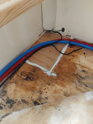

Hello I was wondering if anyone could help me. Our Bailey pegasus caravan has been damp repaired. Paid £580 for damp to be fixed only to find out by another service man that no work had been done. It had only been painted. We got the man back out to fix the damp which he should of done in first place. However now it's done it has left a hole in the back corner. The man said this is ventilation hole. I don't think this is correct. If someone could clarify for me please.

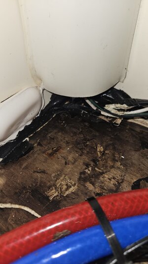

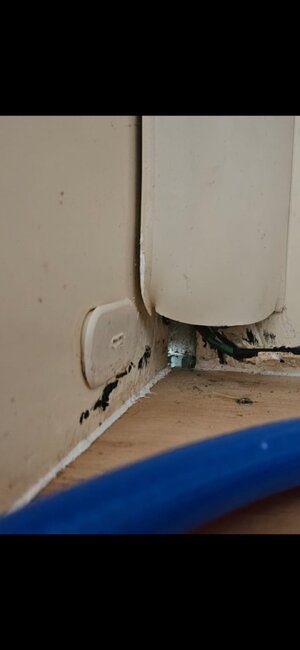

Your "Repair man" is talking out of something other than his mouth! That is a totally ludicrous thing for him to alledge.
Personally I dont like the look of the sidewalls either side of that "Ventilation" point, looks suspiciously like rot to me, the bead of silicone sealant along the joint also rings alarm bells.
Total rubbish, the guy is conning you. I’d talk to Trading Standards as he’s plainly incompetent and verging on fraud, and a danger should he do work elsewhere on a caravan.
Thanks for replying. This is the "fixed"job he said he has done. He glued the lino back down so we couldn't see anything. We pulled it back to find this. Total rot.
Then he came back after we rang him and went mad. Apologize for not carrying out the work correctly came and fixed it again (second picture). And left a so call ventilation hole. I have young children and a newborn baby. This is right under the back bunk bed. I really don't know what to do.

It’s still a totally an unsatisfactory repair. Tell him you want your money back or you will report him to Trading Standards. Then get a AWS Approved Workshop Scheme technician to survey the damp and give you a price to do the job properly.

Am I right in thinking you still have to get the caravan repaired?It also highlights the problem of approved/recommended schemes i.e "Checka person " " trust a trade" and "approved Worksop scheme" and "Gas unsafe":- names have been changed to protect the guilty . The approved members have met certain criteria ( one of which is an annual fee to approving body) but it does not GUARANTEE competence of its members,and the approval body takes no responsibility for work its members undertakes ( Watch rip off Britain).Even now, word of mouth recommendations are best. Re the black walls , they are made of composite plastic so the mould shouldn't get a hold on it,Re the "vent hole" Next time I see a Bailey I'll have a look, after all most caravans have 'vent' holes in the floor
