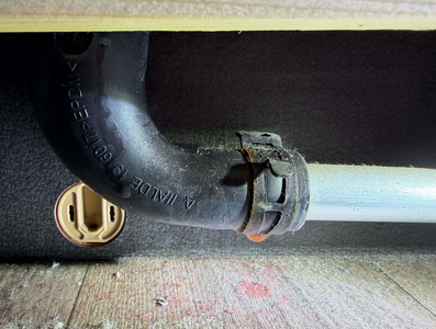

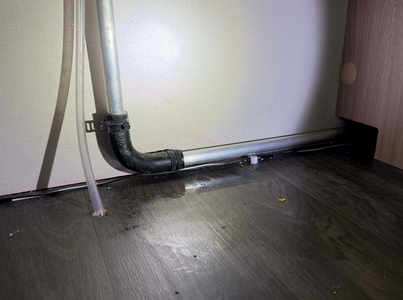

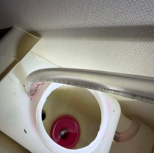

Looking more into it, looks like the ALKO Heating fluid has reduced
My thoughts there is a burst under the panel in the bathroom from the radiator
Wife is calling the Service guy, who also thankfully works under the Swift warranty.
Our service guy has called back and said this will still be under warranty, we bought the caravan in Oct 2023, he also said we haven't had much luck with this caravan...
Can anyone recommend what we need to do now, seeing how this is Gycol
Presume all the wood will need to be checked, and anything stained by the liquid will get replaced under warranty?
Hose pipe under radiator in bathroom:
Under the main tank in cupboard:
Tank just about empty:
Contact your dealer and get it booked in for a warranty repair. Glycol is miscible with water so the affected area can be thoughly washed with hot water and detergent (Flash). Any ‘sweet/sickly” smell can be tackled with white vinegar and water solution. 1 part to 2. Then let dealer sort it out.
