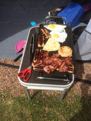

We use an electric hot plate more than the caravan hob, I think it was around £25, brilliant bit of kit and easy to clean.
