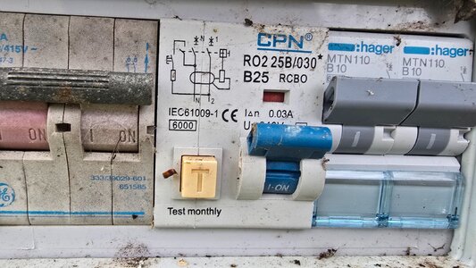

In the caravan it was the mains switch on the left that tripped. In the site box it was the blue switch that tripped. No other switches moved.
I know very little about electrics. But is it worth running your cable to a different site box if it's long enough. Just to eliminate that it's not a fault on the site connection.
If it was a on the site connection the caravan RCD would not trip. An RCD only protects circuits that are after the unit, i.e. the pillar RCD protects the EHU cable, the caravan RCD protects the appliances in the caravan.
