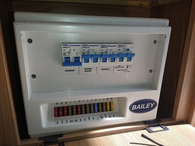

you will need either an electrician or a non contact voltage tester -(stick) which when placed near a live wire will indicate whether 240V is present , (See photo) Also you may need to check with site owner in case their MCB back in the distribution board is OK , If another caravan is hooked up close by ask them to plug into your 'post's outlet to see if it is working.
Also inspect both ends of the hookup cable looking for damage as something has popped the post's fuse .If the supply to your caravan is intact then the EDU (distribution system) inside may have tripped again, both the RCD and MCB need to be on , Once you restored the power on the post , the fault inside the caravan may have tripped again.

I think a little explanation may help.
The power box will consist of one residual current device or RCD and three electronic 'fuses' called miniature circuit breakers or MCBs.
The RCD monitors that there is no current escaping through a route other than any appliance etc connected to it - like a human - and will switch off at 30mA (0.03A) of fault current usually in less than 25mS (milliseconds.) The switch part of the RCD carries ALL mains into the caravan and will be rated at 25A minimum or even 40A or 63A dependent upon the manufacturers design.
The MCB ratings vary according to application. The mains sockets in the caravan will be fed through a 16A MCB; the water heater will also be fed through another 16A MCB; the battery charger and fridge will be run through a 6A MCB. An MCB is simply a resettable fuse - a switch rather then a piece of fuse wire.
The electricity supply source will also run through an RCD or MCB in the pillar or in a multi-user power box.
What puzzles me is your reference to a meter. Are you talking of a supply usage meter for monetary charging, or do you mean a voltmeter showing the battery state?
For the record the fuses (in the recess at the bottom of the power box in the photo) are only for the 12V circuits. In many vans there is also a small fuse block at the front under one of the front seats/bunks which protect the cables carrying power for battery charging and the fridge from the towing vehicle. The caravan external road lights are independently fused.
HTH.
HTH.
I'll fetch me coat...........................
