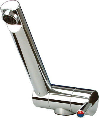

The real problem is not many people sell or make the lightweight folding taps from earlier years. I found this one on EBay . It fits the bill but not cheap. A real pita but a sellers market😉
