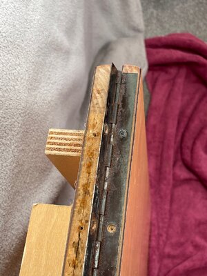

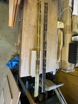

Then there’s the rusted flap hinge which was beginning to stress and fracture the flap top. Found a solid brass piano hinge in the workshop from thirty years ago! See pics

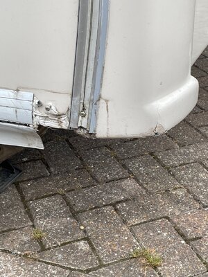

And then there’s my Mea Culpa moment see pics.

You might be working the Old Girl too hard given her mature years. Is a visit to Somerset on the cards; that’s an unfortunate knock.
21,894
7,142
It’s going to be DD DIY Clive. The Bailey cap is on order £25. The rear panel is hardly anything but on a curvy bit. I’ll gently fill sand and spray locally with Bailey Magnolia
