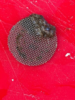

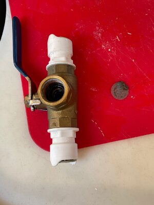

Last year we had a blocked water system. The fine mesh filters in the two three way taps to the pump were well gunged up even though they had been cleaned with Milton and latterly Puriclean. Yuk🤮🤮IMG_6105.jpegIMG_6107.jpeg
