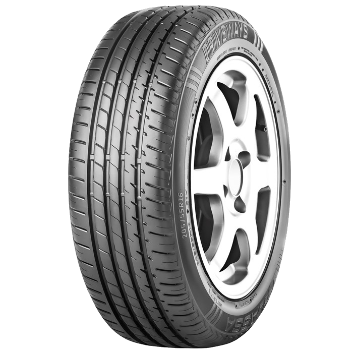

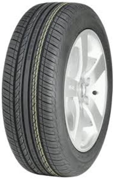

Our Buccaneer had Ovation tyres fitted from new, they were C rated. I replaced the tyres on my Buccaneer back end of last year with Lassa tyres which are C rated. Not a bad price, but hopefully better quality then the Ovations.
Why are Lassa likely to be better quality than Ovation?

Ovation tyres do not do well in tyre tests, generally not performing in the various tests. The Lassa tyres do much better in the tests, so I think they must be better quality, or is that not right? I did not state that the Ovation tyres were poor quality, just that I think the Lassa must be of better quality to out perform the Ovation. If one tyre out performs another then surely the higher prtformer must be of better quality, or is that not correct?

Why do you have a problem with me thinking Lassa tyres are better quality than Ovation?

When I looked at some German tyre testing sites Ovation had better performance than Lassa. But of course these are specific to the tyre models tested for comparison. They don’t rate quality which is quite different to performance. But thanks for the links.

It was an Ovation tyre on a previous caravan that blew up on us while parked on a site. Any thing has to be better than those tyres.
At 11 months they were showing cracking on the outside and this was in 2017. I think the age of the tyre at that point was about 2 years. Obviously in storage for several or more months!
Ovations are popular with the trade I think as not only are they cheap but they are also very light. I removed some from a set of wheels and while I didn't weigh them I swear the tyres going on were as heavy for 1 as a pair of ovations.
