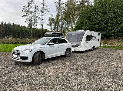

4. Is there meant to be a light rocking back and forth now and again when driving, is this normal?
I note from your picture you have a twin axle (TA) caravan. Depending on how the caravan rides when hitched, the dynamics of the caravan when in motion can cause the effective centre of gravity to move a little. This can make a TA produce a rocking sensation. Generally the advice would be to check the nose load the caravan is imparting to the tow ball, and if there is any scope within the vehicles specifications increase it a bit.

With that tow car you should not feel any rocking, but make sure that the nose weight on the hitch is at the maximum of 100kg for safe and probably better tow. However it could be the cars suspension creating the feeling of rocking while travelling. Is it normal suspension or air suspension?

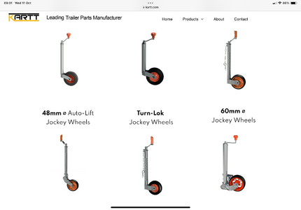

The ALKO jockey wheel looks flimsy in comparison to the Kartt JW. Our twin which is 2000kg does cause the ALKO jockey wheel to look like it is bending when using the mover. We have replaced it with the Kartt JW which is a lot sturdier.

To get around the issue of fitting the ALKO locks there is a simple solution. Invest in a Lock n Level system of the caravan. See https://www.locknlevel.co.uk/twin-axle
The Audi has normal suspension, ill check the nose weight again this weekend.
I think by the looks of it the next upgrade will be the Kartt JW, does anyone know what size is best to go with? There is a quite a few to choose from.

We bought the 48mm heavy duty ribbed jockey wheel. It does increase your nose weight by about 3kgs so no big deal. We bought direct from Kartt. I think the code was KJW4809W.
