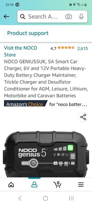

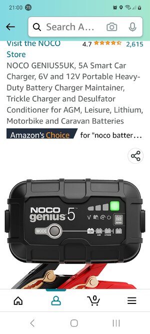

Thank you for your replies, I have ordered this charger,I have lived in the caravan for 5 years,with mains electric, maybe time for new battery

Thatโ€™s a good quality smart charger. Donโ€™t write the battery off too quickly. See what time on the NOCO achieves. You could also check the battery connections. Not just the clamping terminal to the battery but the security of the cable wires within the clamp.

I'll second that - 5 years with the battery connected to an onboard supply giving 13.8v float voltage will have allowed substantial sulphation - a good smart charger will go through a reconditioning cycle and help restore it.

Thank you,its a expense I could have done without at moment, but it will come in handy,had car flat battery last winter,could have done with it then
