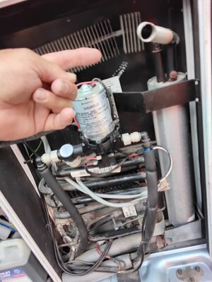

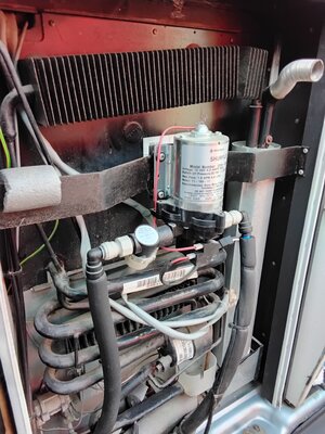

That seems VERY wrong to me! There should be a "chimney" above the flame that runs up to, and exhausts through, the top vent! Like below (this is on a panel van conversion so the vents are on the back door, hence the back of the fridge being so accessible!

@mr plod I can honestly say I have never seen a water pump attached/almost attached to the rear of a fridge before. How odd 🤔
The water pump is firmly attached to a substatial bracket !
Don't forget this set up is on a Panel Van Conversion not a caravan and the picture is taken from the rear of the van with the back door open. The bottom door catch is visible at the bottom right of the first picture. Being a PVC space for habitation equipment is at a premium, hence the location of the water pump. At least its very accessible, as is the back of the fridge.
Oh that kind of makes sense, I was thinking it was inside a fridge vent somehow 🤔🤣
On the bright side it won’t freeze when the fridge is on🤔

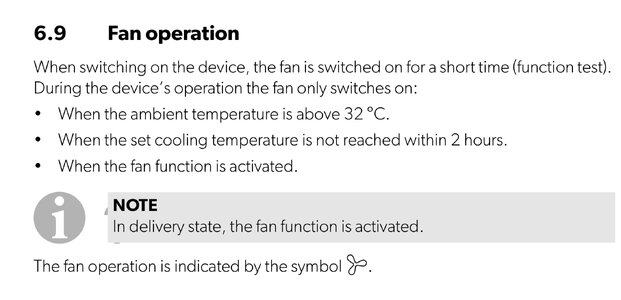

To update.
I have not fitted the fans to my fridge for two reasons.
First, the fridge has worked very well in early 30’s temperatures.
I read the instructions for the series 10 Dometic. Seems it comes with a thermostaticly controlled fan as standard.
But Is that fan internal to circulate the cold air within the fridge (like my one at home does) rather than an external one to aid air passage over the heat exchanger?
Your fridge works well enough for you, and thats all that matters to you, but many owners find theirs dont cope so well, hence this thread!
Good question. It is an external fan. These are the instructions.
I agree that others will find fans useful. Fans worked very well on previous fridges.
