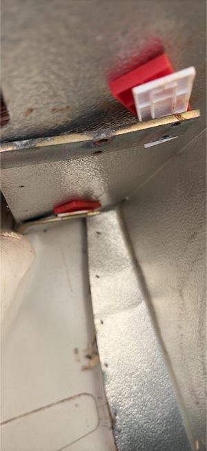

Hi everyone. I have been renovating my little rot box since November. I am now working on the front. The shelf had disintegrated in places at the front so my ‘template’ is largely absent. The ends of the vertical battens had gone too. I had installed a new shelf based on the outline of its predecessor and all was good but it’s not sitting on the brackets in the front locker - there’s a 10mm minimum gap. I then added a strip of full width ply to the underside of the shelf but by this time I’d applied too much downward pressure and some of the screws had pulled out from the interior batten. The shelf looked as though it was tilting down a little towards the front end. Perhaps the ply strip is causing that? So, I have disassembled 😢and need to revise my approach.
My brackets have a slight bend in the horizontal bar - especially the 2 nearest the sides (I have 4 in all).
Can anyone talk me through the stages involved in installing and fitting this shelf correctly? Please . . .🙏 Thank you so much
The photo of the front locker shows the packing whilst the glue cured for the plywood strip but also shows the ‘bent’ bracket. The new shelf and front ply have all been removed now and I am back to battens and aluminium firewall.

Having done a few Elddis caravans ( removal of the whole front interior and front shelf) the front shelf is supported at the sides by the side walls and there were screws which went from the outside into the shelf and you can't replace these unless the whole front ABS/Fibreglass panel is removed. So to provide support you will need to add wooden pieces below where the side pieces finish and then attach pieces to the sides which will support the shelf . I use PU expanding Adhesive to attach the pieces together. Unfortunately I haven't taken pictures to better explain how you
Thank you. I have taken out everything that i had done , stripped it back and re-done it. Much happier with the result. Expanding adhesive is a good idea - I will get some. Thank you again
