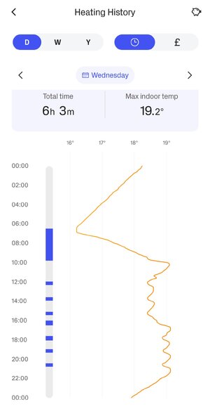

Would be interesting to know how hard the boiler is running to do that. On our system, gas boiler with weather compensation, it takes about an hour per degree to heat the house from 16 to 18.5* on these cold mornings. However it's a 15kW boiler but apart from when it's heating the hot water when it gets to 11kW (flow temp 80deg) it rarely runs above 5kW due to the lower flow temperature (40-55 Deg C) for the heating.
I'm still experimenting to find the most economical way of running it, so far it seems to be maintaining an even temperature all day, even if we are out, rather than heating and cooling the house.
* Thermostat/timer is in the hall which is a 1-2 degrees colder than the rest of the living area.

That’s similar to our temperature drop overnight last Tuesday until mid day Wednesday and the overnight outside temperature was minus 2 deg C. Post #194 shows the cooling and heating curve.

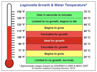

The only downside is that below 50C it is possible for legionella bacteria to grow so it's close to the edge.
This is alleviated by doing, when electricity is cheap or the sun is shining, a weekly heating on the immersion to 60deg.
Most of the year it's not a problem for us as we also have solar thermal water heating.
