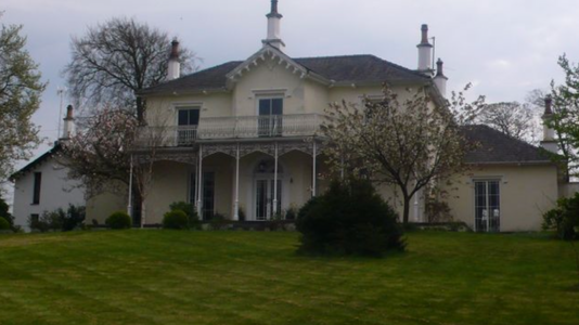

Well there is at least one more.
Our property is totally unsuited in respect to its inherent insulation, we also would have the same level of upheaval re radiators and distribution system.
We are fortunate enough to have the land area and an ideal orientation to go ground heat source, but in our mid eighties with significant health issues on hassle alone it simply is not tenable.
Cost wise, yes, its expensive to pour high levels of gas energy into the place. But that cost now and realistically into what is our possible future, paying for energy is going to be way cheaper than, the total for adapting our place into one that is heat pump viable, install it and then its own running cost.
Its not going to happen, despite a desire to help preserve the planet, that has to be tempered with its "hurt" to me and mine. Shame but simply can't cope with it.

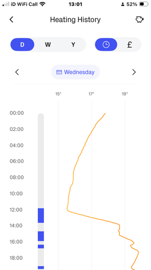

Ours dropped by just under 3 degrees C over 12 hours last Wednesday until mid day Wednesday.
