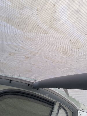

It is a vango sonoma 350 air awning. The best way to describe is “Like a glue substance” on the inside of the awning.

Looking on Google it is common problem with Vango.
Se what you mean. It’s as if the waterproofing is a coating sprayed on the insides. Never had an awning with that material feature more akin to a lightweight tent coating. But even they last better than yours. I’ve a Vango 350XL tent but the inside is still in A1 condition.

I wonder if this is the result of condensation? My no longer used Kampa Rallye Air was notorious for condensation on the roof. As a partial cure Kampa sold an inner ceiling lining.
If the Vango issue is a common one and is in effect a fundamental design defect present at point of sale I ‘d be having words with the Dealer, or did you buy direct from Vango?

My guess would be that it is caused by one of two options.
1. The surface of the fabric has degraded and has become sticky.
or
2. It is growth of mould over the surface.
If the awning is a write off as it is then you have little to lose with a draconian scrub of the surface with a proprietary awning cleaner or mould remover. Then a reseal with Fabsil.
If you think the awning is still useable then you may want to try the above on a very very small area first and see what happens.
Do report back.
