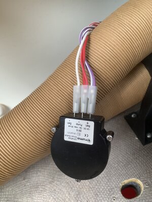

Thank you for taking the time to reply Martin Just in case anyone might find this thread helpful... I swapped the Truma smart switch for the Whale pressure switch today. The photo identifies the connections (Bailey colour coded cables). I connected the “-“ cables labelled ‘pump’ & ‘batt’ to the Whale switch and left the ‘batt +’ disconnected. The Whale switch needed a little adjustment and works as it should.
Thanks again
Joe
Thanks again
Joe

Hi Joe new to forum and a caravan returner I’ve bought the whale wu7207 to replace what I believe to be a faulty truma pt2 today do you mind confirming it’s the battery positive that you’ve left disconnected?
Richie
Richie
Hello Richie, Bat + left disconnected as labelled in the jpeg. All still working fine.
Cheers
Joe
