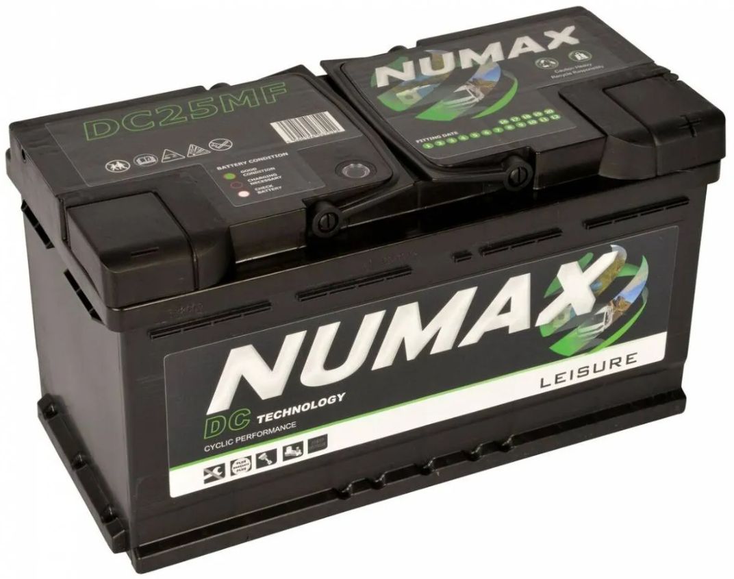

Have you tried Tayna Batteries? You can put the physical size of the battery in and it will show you the options available, along with the terminal layout. I can recommend the Numax DC25MF 105Ah.
Yes I have been on their site, I am restricted to 190mm in height because of the fitting area. I would love it to have my connection plan.

What type of terminal connections do upu want to you use? The Numax height of 190 includes the terminals.

This expert's video shows a Numax battery being fitted yo a Pamplona
Having watched that video I don't understand the OP's issue - the battery can be fitted either way round and the cables are long enough to cope with either terminal layout - the only issue is the battery height but 190mm is a common height for leisure batteries.

I have used these batteries in the past, they last well and are low profile if the height is an issue
Numax also do a similar size 190 height

190mm is a common height these days. My last caravan was 190mm and I fitted a Banner battery. Yes it was tight vertically but the battery fitted okay with its cables routed. The previous battery on that caravan was Exide again tight but that’s how they are.
