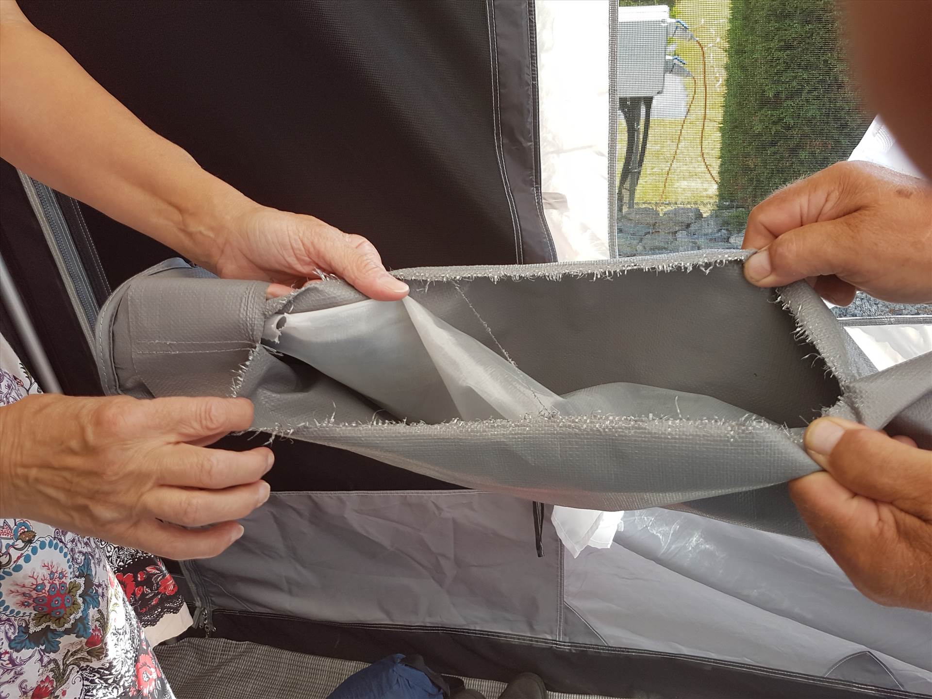

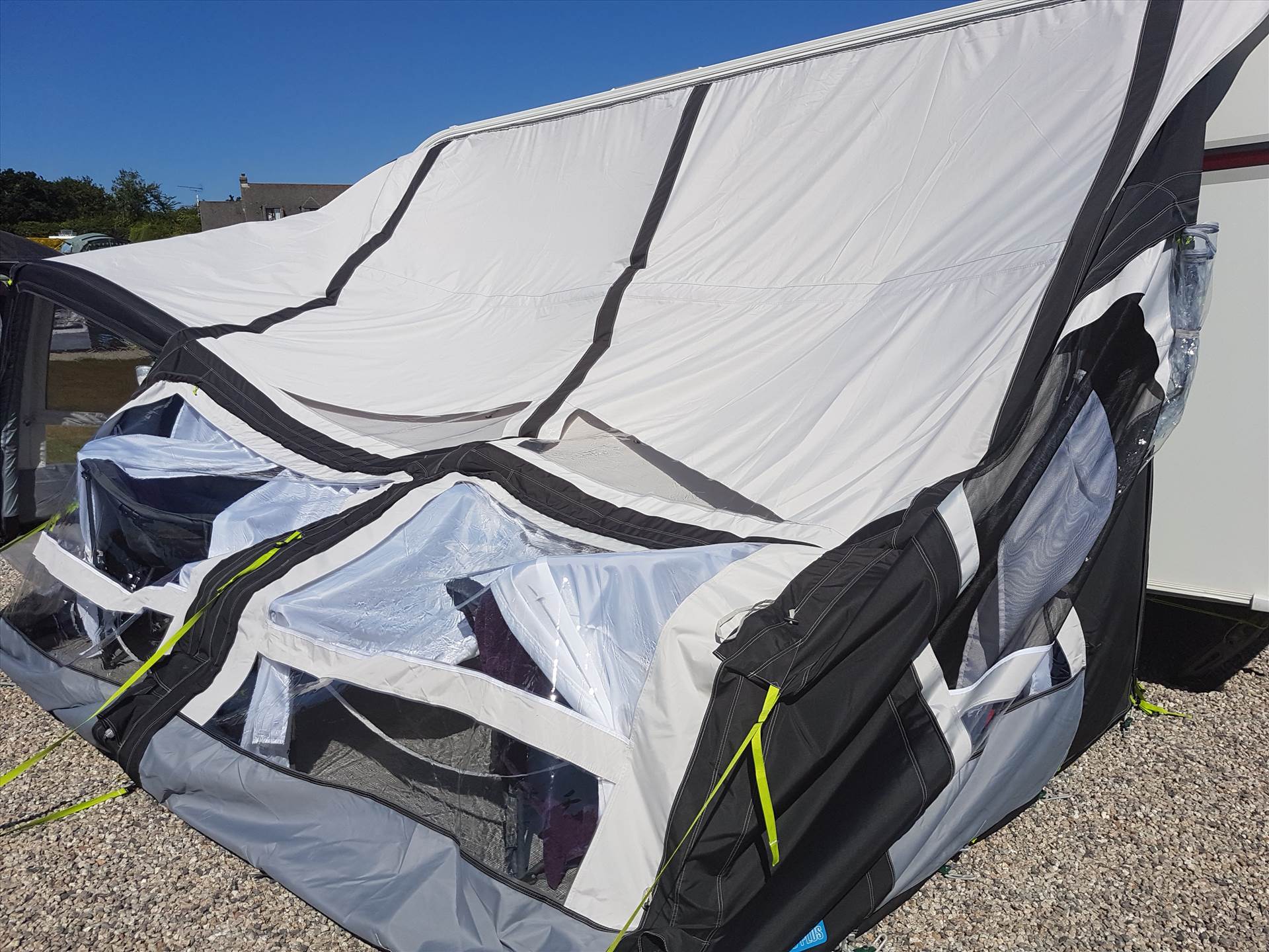

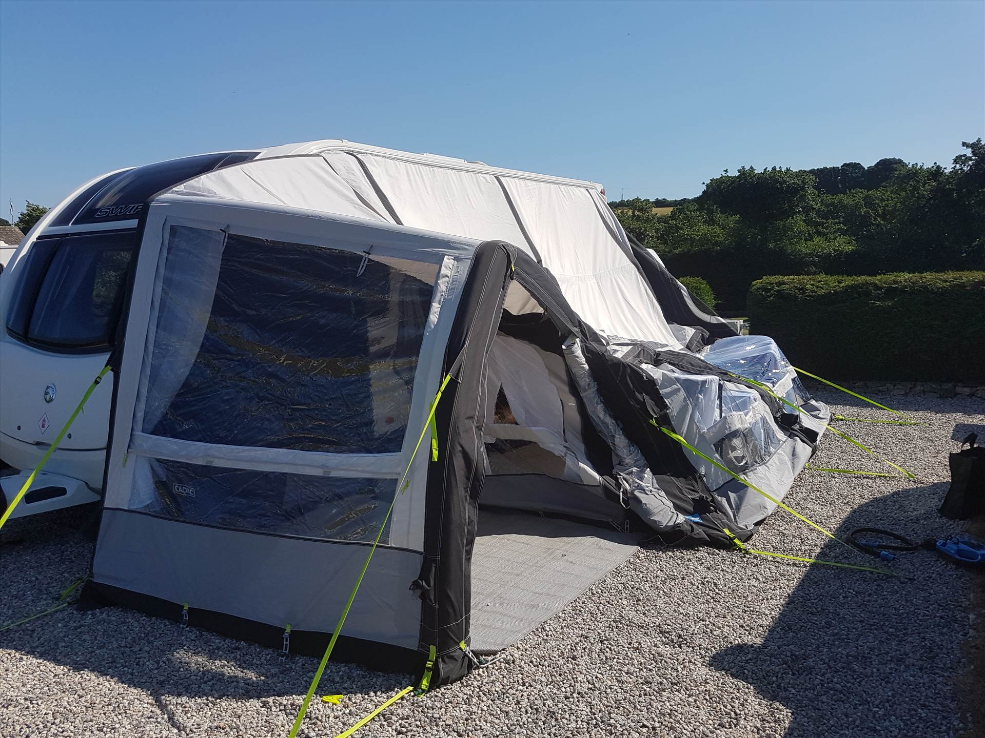

Well well, used our new Kampa Air 390 pro Plus for the first time and probaly the last time.
Having been up for just a few days, the rear air pole exploded with one hell of a bang. It hadnt been over inflated, Kampa say 9 to 11 psi, ours was on 9psi. Yes, it was very hot, but Kampa claim to have tested these in Australia for 20 months, a wee bit hotter than Cornwall one would expect. Spare poles dont appear to be stocked by dealers and have to come direct from Kampa, which is fine whilst th awning is under warranty. I am concerned about how we would go on if out of warranty or abroad. It went on a Saturday, which meant it was late Tuesday before the replacement arrived. I cant fault kampa for that.
In their own words
"this clearly shouldnt happen", however reports of just this event are legion on the internet.

That looks very much like a manufacturing fault. I would send it back for their review and a claim. BTW Kampa aught to be careful what with condensation and other faults their sales my well slump.

I have just put the phone down to Kampa and what a poor attitude. The handbook clearly states that the awning should be inflated to between 9-11 psi. Kampa aftersales have just told me that it is 7-9 psi and when I challenged them they insited it was correct. Having spoken to a manager later in the call, the pressures are indeed 9-11 psi, the girl was totally wrong, and their excuse is that she is new. Not wanting to be hard on her I replied that she should have been trained properly before bcoming customer facing. They now say that they recommend in hot weather an inflation of 7-9 psi, but that information isnt directly available to the public and would only become knowledge following such an issue.
