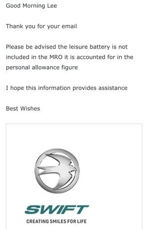

It can be so confusing as some caravans with powered self levelling systems do include the battery in MIRO. Why in earth having full tanks in MIRO is beyond me.
As far as the OP is concerned his MIRO does not include a battery if the Owners Manual is to be believed. Crikey it’s difficult.
If the battery was not included in the MIRO then the self levelling would not work. That would be like trying to demonstrate a car without a battery. LOL! :LOL:
