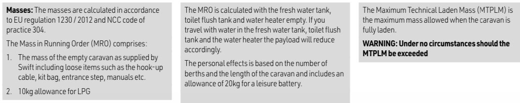

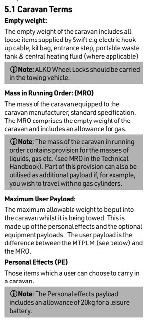

Just out of curiosity, shouldn’t the dealer know what is included in my Swift Challenger MRO?
When we visited last week and sat down and asked for example if a gas bottle is included, I asked this very question, he then proceeded to look on his computer and told me there wasn’t anything.
I have since found out by looking at the Swift Handbook the LPG cylinder at a weight of 10kg and the leisure battery at 20kg, also includes elec cable and step are all included.
Does anyone find this odd that a sales person, probably selling them weekly, when asked this, should be able to provide correct info? Surely giving us the correct info would have helped us.

The battery is not included in the MIRO as that weight comes out of the user payload.
25,892
9,558
Post #108 by the OP shows a photo of the handbook which clearly states the battery isn’t in MIRO. It’s Personal Effects payload.

I would say the MRO includes 10kg for the LPG bottle and PE (Personal Effects) of 20kg for the battery.
Am I wrong turn in saying the battery isn’t included in the MRO? :unsure:
16,925
5,504
It is confusing the way it is written, but the way I read it is that the battery is not included in MIRO and is part of personal effects. A reasonable battery for that size of caravan would weigh about 25kg.

It can be so confusing as some caravans with powered self levelling systems do include the battery in MIRO. Why in earth having full tanks in MIRO is beyond me.
As far as the OP is concerned his MIRO does not include a battery if the Owners Manual is to be believed. Crikey it’s difficult.
