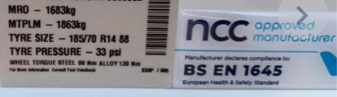

The photo that the OP has posted of the sticker on his caravan doesn't conform to legal requirements so there must be another weight plate elsewhere which does.
I don't recall anyone stating it was a legal sticker. After all the sticker on the side of any caravan is not mandatory so need for it to conform to any legal requirements, but that is another debate that has been done to death on this and other forums and the OP probably has no interest in any legal arguments.

I don't want to draw this thread into another never ending discussion, but if the caravan manufacturer is not a member of the NCC it wouldn't have the sticker by the door so the powers-that-be would have to go by what the statutory plate says. Besides, what's the point of having an MTPLM on the statutory plate if it's ignored? If one ignores the MTPLM on the statutory plate one would also have to ignore the maximum allowable noseweight and maximum axle load, which are also on the statutory plate but not on the sticker by the door.

Without wishing to stir things up I will just say that is not the official statutory weight plate. The official plate will not give details of the MIRO, nor of tyre size or tyre pressure. Instead, it specifies the maximum permissible noseweight and maximum axle load(s).
8,594
1,819
It is not identical to the one on mine which actually shows not only the MTPLM but the design weight of the chassis which is 30kg heavier.

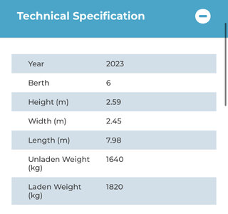

Just to throw a spanner in the works, I’ve just looked at the website advert technical page section, which doesn’t match the plate.
Could it be the plate will get changed when it goes through the PDI?

I noticed that the other day when you first posted. I suppose it could well be that your particular model has optional extras fitted that has bumped the weights up? We're currently looking at an Adria and the spec sheet lists 2 x MIRO's and 2 x MTPLM's for the same model depending on options fitted or not. I wouldn't get too hung up about it as the differences isn't much.
I note that, in their tech spec, Adria refer to a, quote, MTPLM-min. What are they playing at? Either it's a maximum or a minimum. How can it be both at the same time? One can be a standard MTPLM and the other an optional MTPLM, but not a minimum and maximum MTPLM. If the terms 'minimum' and 'maximum' are used, then this suggests that there is also something in between.
