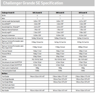

It seems that that is the upgrade as original MTPLM is 1820kg.
But the original spec states MIRO of 1640kgs so it could be the OP's caravan is a higher spec? Either way, the dealer will be able to confirm. Just looked at the specification of the caravan, it sure looks to be an impressive set-up!
Hmmm it's not leaving much then with the motor movers installed, as part of the deal
110kg isn't a lot, unless we use our car and roofbox for more items.

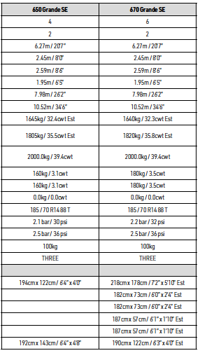

The Grande definitely has a MTPLM of 1820kg therefore at 1863kg it has had the upgrade. https://www.swiftgroup.co.uk/caravans/product/1306/swift-challenger-grande/#configurator
BUT the photo the OP took of the plate shows an MIRO of 1683kgs, the Swift spec shows it as being 1640kgs, so the MIRO is higher than the spec states.
We'll have to wait for him to get dealer confirmation as an upgraded MTPLM USUALLY takes it up to the axle/chassis maximum rating which (from what I've seen) is usually a round number (1900kgs, 1950kgs, 2000kgs etc). An upgrade to 1863kgs (to me) just doesn't look right.
