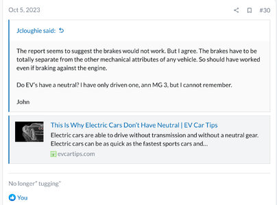

The report seems to suggest the brakes would not work. But I agree. The brakes have to be totally separate from the other mechanical attributes of any vehicle. So should have worked even if braking against the engine.
Do EV’s have a neutral? I have only driven one, ann MG 3, but I cannot remember.

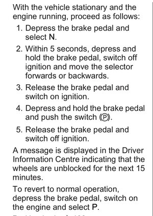

Further to the above.
I had the use of a Moka EV today, quite a pleasant drive though a little small. It did have a neutral. I never used it though.
Out of curiosity I looked up the manual, seems it is there as a freewheel mode for some car washes. But the procedure to use it is a tad convoluted.
Sounds more like something your GP would use to assess mental capacity. 😂
Imagine the queue that could form whilst ferreting around in the glove box, then getting timed out after 5 seconds.
