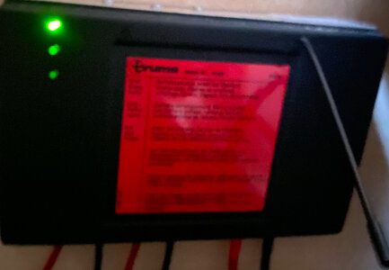

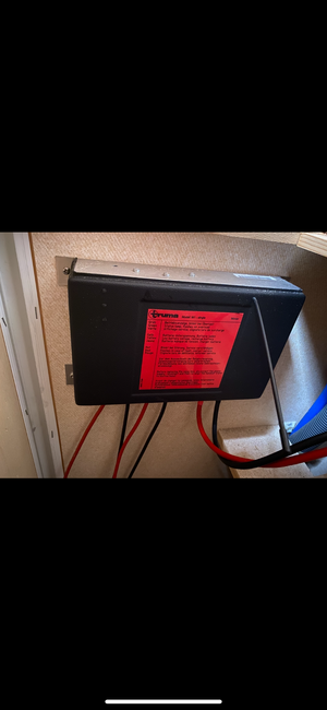

When I insert a pencil in the reset hole, the green light comes on for about 10 seconds then goes out, so there must be power going to it, still not working

Good, but it almost certainly needs the handset to be linked digitally* to the control unit, what Truma call "Align"; see their page 18 in the document I identified for you in post #15
* establishing a radio signal digital "handshake" so your controller only operates your relay box.
Make absolutely sure the rollers are not engaged with the tyres whilst setting it up!
