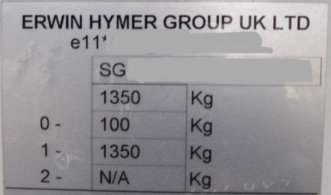

Can someone perhaps post photos of statutory weight plates so the uninitiated can see what they look like. We regularly see photos of car statutory plates.

All weights on the statutory plate are legally enforceable, including the MTPLM.
Here's a of photo of a statutory plate that meets all the requirements:
(The owner has deleted the e11 type approval number and, understandably, the VIN from the photo, both of which are, however, required to be displayed on the statutory plate).

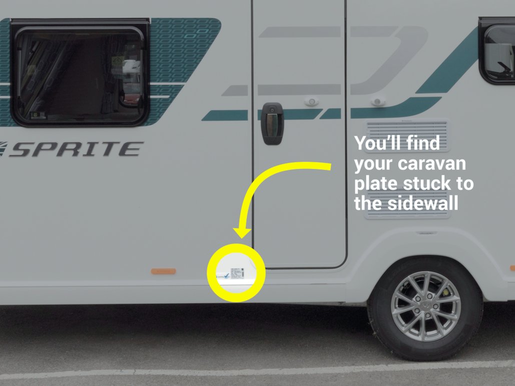

Same here Hutch, only a weight plate by the door.
But both axles have weight plates 1000kg each.
I believe, not sure , newer model caravans may well have a weight plate inside the front locker near the bulkhead.
Strangely neither Swift nor Bailey offer weight upgrades plates other than those fixed by the door.
A caravan built in 2013 was not subject to whole vehicle type approval as that wasn't introduced until 2014, and the plating requirements before that were nowhere nearly as specific.

They don't have to because the statutory plate will already show the higher MTPLM and the sticker by the door for a so-called upgrade only brings the MTPLM into line with what was already there all the time. Effectively, they don't change the statutory values at all.
