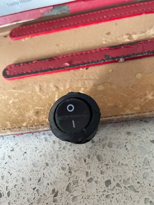

Can you post a photo ? I've taken lots of switches apart over the years and asProf John says its relatively easy to remove the rocker and turn it 180 degrees and refit the rocker.You will need a couple of watch screwdrivers and a white sheet (to catch the the really small bits if they fall out!!) and a multimeter to test the switch when re-assembled

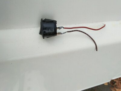

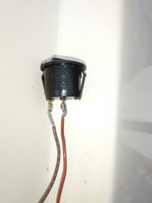

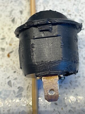

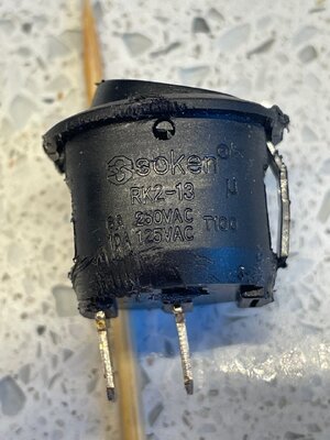

Try this. I can take more later showing the bottom and sides
19,278
4,473
Are those the old or new switches? either way (not about the action of the switch) they are in a terrible condition, Is there a reason they are have so many scratches and other marks?

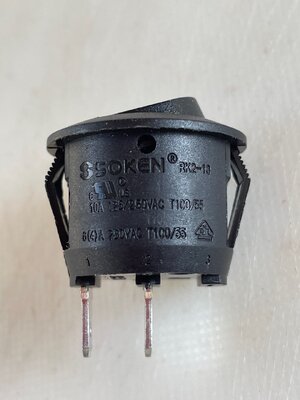

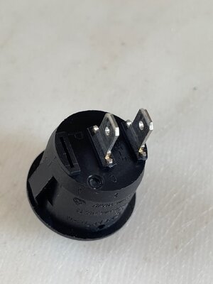

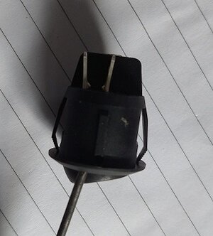

DD,check in technical section on a posting I did under"rocker switches" it may be of help..June of 2025,images of similar switch I have in front of me,try a Halfords or similar place,marketed by a company called autobarIMG_2025-09-30-09-28-39-538.jpgIMG_2025-09-30-09-28-17-850.jpgIMG_2025-09-30-09-28-17-850.jpg

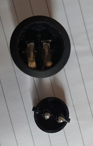

thats a standard switch , I have several in stock and have even fixed a few . If you get the smallest of watch screwdriver down the side where the hinge is and gently prise out the rocker , turn it through 180 degrees and reinsert

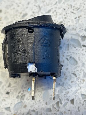

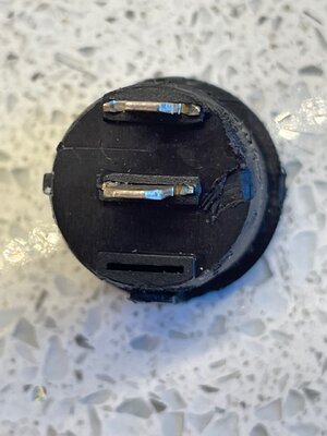

Yes. This is an old and brittle one. It took a Herculean effort to get it out of the housing without damaging the housing itself.

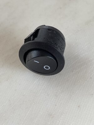

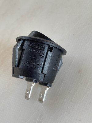

Here’s some pics of the new one which seems to go in and out of the housing easily.
Hopefully the correct replacements from Prima Leisure will arrive this week.

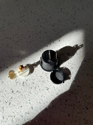

So the new replacements arrived foc this morning. Rubbish! Still the wrong way round!
I’ll try Ian’s method on the old ones and see if it easy to swap the rocker as suggested.
Frankly it’s not a major issue but yet again the very poor attention to detail shown by caravan manufacturers and their suppliers.
Let’s see how good they come apart😉
20,435
5,584

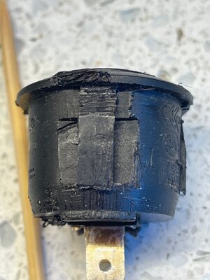

Pulled the old one apart per Ian's suggestion. All sprung apart so hard to get back to ground zero.🙀
You need a magnifying glass , fine surgical tweezers and luck to reassemble. Even if I get it back together it may not be correct and could become a potential fire hazard🙀
End result we will live with the wrong orientation 🥲
