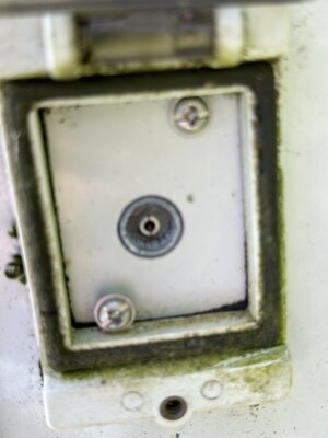

We’re on site at present and the wifi is bad, and we can see there’s an option for a coaxial cable to be connected on the same mains power box.
I found a coaxial cable point but it’s for going from the caravan to the awning as an output.
Is there an input from the mains box into the caravan on a challenger Swift caravan? As I’m stuck and can’t find anything :(

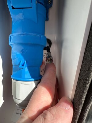

Thanks just checked, I have this in the battery box and also photo of the output at the power box
Any idea what cable ?

The fly-lead in the battery box has an 'F' (satellite) connector the connector on the post looks to be a 'normal' TV aerial connector. On our caravan the external aerial input is only connected to the 'front' TV point satellite output not the TV aerial.

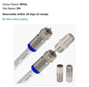

Is that not just the Sat cable bud?
There is a coaxial cable output on the power box but only a Sat cable input on the caravan?
Do you actually get cables for this or am I wrong and the Sat cable input is only for a Sat dish?

You need a length of satellite quality co axial cable, available to buy on line, we chose red so we can see ours, you order it with satellite connectors on each end, on one end you screw an adaptor to convert to 'normal' tv socket which is on your hook up. The other end screws onto the satellite cable in your picture, this will give you terrestrial Tv into your caravan,now you need a short co axial satellite cable , you screw one end on to the satellite output next to the TV 240v socket. Then the other end needs another 'normal' adaptor fitted, this then pushes into the back of the TV, Now set your TV to tune in to 'aerial' settings and you should be good to go. Once you have the long lead from the post you can use it either off the post or off a dish if you have one, all you need are the various adaptors. There are several on line satellite supliers that supply everything you need.

just seen your new post, that is mainly what you need, 5m may be a bit short, you will also need the short one to go from back of TV to satellite point

No, it's going from an internal location to an outside location and is a piece of cable with a connector on either end. The internal end will likely be presented next to the aerial amp to which it is connected. To use a signal from the power pillar just disconnect the external cable from the aerial amp and disconnect the cable on the aerial amp that feeds the TV socket inside the van. Connect them together. Plug in your TV in the 'normal' way.
Outside make up a piece of cable - usually about 25m - with the appropriate plugs on either end so that it will plug into the pillar and to the caravan. Plug in, retune your TV and all should work. Note that there may be frequency changes on the site system such that the incoming signal from the pillar may not be on the same channels as you have received off air.
You can buy the necessary connectors and cable from Toolstation or Screwfix considerably cheaper than from a DIY shed. The 'standard' TV connector shown in #11 are known as F-type, that in #13/2 are called Belling-Lee (for which this needs plug to mate with.)
