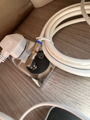

Hmm maybe I’m mixing outputs wrong?
In the front of the caravan we have an output for Coaxial cable and Sat (RF) cable, on the other side is USB and 12V power
In the back of the caravan we have an output for 12V and just coaxial, which means the input from the battery box (Sat RF) only connects to the front room output point.

I would have thought that in the battery box there would have been two connections, one for RF and the other for a satellite connection, but probably on newer caravans.
Previously we have disconnected the feed from the status aerial into the power supply and connected the RF from the battery locker in its place however this meant a loose cable under the front bunks. Signal then throughout the caravan.
You could do the same with the satellite connection, but you will probably need to remove the connection from the satellite signal splitter, add a cable to go to the power splitter by the status aerial for signal all round the caravan.

Don't you believe it! Anything that saves a halfpenny in product unit price or even a penny in fitting costs and the caravan industry will snatch your arm off.
In respect of the back socket, just change the aerial plate. The chrome retention plate usually just prises off and the socket plate is held by two screws. You can buy the plate with one F-type and one Belling-Lee from any caravan parts supplier. I {think} the manufacturer might be Berker. These sockets may be an F-type and a Belling-Lee on the user side but the rear is usually F-type on both.
I would have thought that the satellite in feed and the RF feed have their own splitters therefore changing the the back socket will not make a difference in the signal is coming in through the socket in the battery box as there may not be any signal to that socket?
Normally satellite and RF feeds are separate like in our caravan however I have no knowledge of the layout in the OP's caravan.
