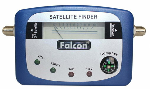

The cheap looking Sat Finder, is this supposed to be switched on, or is it powered by the signal going through the Sat cable from TV to Sat? I can see it has a volume control on the side but no click to turn on. I had this connect between the Sat and cable to TV but no matter how slow, I was moving the Sat there was no movement on the needle.

No,the sat finder doesn't need to be switched on ,the volume control button is a signal gain control. Did you read the instructions?

The cheapo sat finders are junk,. Our Sproket recommended this firm to me .
The ones just under £100 are preloaded with various satellite codes so you can choose which one to track .. The cheapos pick up every thing and don’t tell you the identity of the one you lock onto!

The angle of elevation varies North to South. Remember there are a few satellites around the 28 deg mark. The Astra 2E being 28.2 Eurobird 28.5 etc. This makes it hard to capture the correct one easily with the meter you are using.Good luck, don’t give up, patience😉
