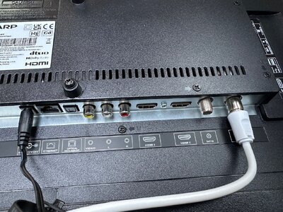

Hi Saxo
The picture of the back of your set shows your cable plugged in to the co axial port, next to it is a threaded port with 'sat in', I would connect the satellite lead from your dish to that and see what happens, assuming you get a signal from your dish on your meter as per Dusty Dog, The next thing will be to go into settimgs on yourTV you should see something like 'tune aerial' or 'tune Freesat' choose Freesat and tune in on auto tuning, you should get over 100 TV channels and also radio channels.
Hi Saxo
It’s ok bud it comes from the Sat in and converted with a plug

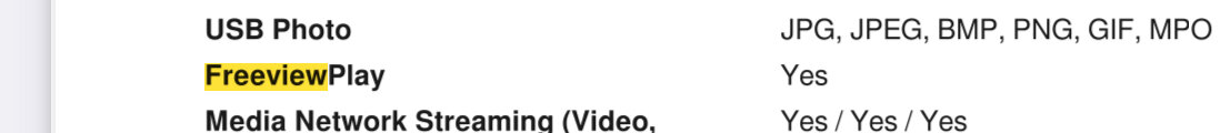

A quick look at the Sharp spec ,it is silent on Freesat. Yes it has Freeview which is different as Bill explained. Then it says it has a satellite input.
  • Satellite input for expanded viewing options
That alone doesn’t mean it has Freesat.
May be a quick call to the dealer or manufacturer will clear this up once and for all.
