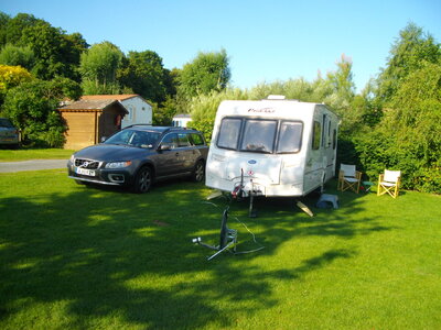

At one site a Dutch couple came over to us and asked what this thing sitting on the ground was. They couldn’t believe it was a sat dish that would pick up British tv for us.

We started off with one very similar which worked okay, but it was always a hassle when it was raining which seemed to be every time we went out. LOL! 🤣
