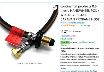

Hello.
Many may already know about the following, but I didn't, so others might not.
I've just had my caravan serviced and got two advisories:
1, The rubber type LPG pigtail connection from the bottle to the regulator has a lifespan of 5 years from the date of fitting and mine needs replacing. Stainless steel braided ones have a theoretical life of 20 years.
2, When my factory-fitted Carbon Monoxide alarm came to the end of its life last Autumn, I replaced it with a quite expensive combined CO and smoke alarm. Apparently, for caravan, motorhome and boat applications the device must comply with BS EN 50291-2: (2019) The one I fitted is the older BS EN 50291-1: (2008) which is still fine in buildings but, not for mobile applications.
More expense, as I had my partially worn but, five-year-old tyres replaced not so long ago..

In my opinion, pigtails are a not-so-expensive but important necessity.

Not knowing how old your caravan is but if it has a bulkhead regulator the gas pigtail has a 10 year life, the orange lpg hose for bottle regulators I believe is five years
