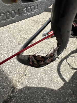

Sorry for this but I forgot to pull y he wore over the hitch and it’s gone through as you can see
Can we still drive but with no ATC?

Of course you can, it's just that the ATC if needed at some point, won't function.
If stopped re lights the statutory defence is
"I checked them before I started this journey"
Very difficult to disprove that! Just saying

Our lights are not working also, and I presume also the brakes
God I’m so worried now and peed off with myself

Black socket is all legal driving stuff, grey socket is auxiliary stuff and reverse lights (not legal on the trailer). If it's the grey you went through, tow for now and cut and re apply plug later.

Only problem is I cannot signal entering or leaving motorways which is what I am getting worried about :( and no brake lights

If you are not technical enough to shorten the cable and refit the plug ( we would be), can you ring a mobile tech who might do it for you. The site may know someone.
Otherwise are you with Green Flag? The caravan has “broken down”

So if I was to cut the wires and reattach them all correctly and insulate tape each wire I should be ok?
I would disconnect from car and then just to confirm would I be right in saying there is no electricity coming from the caravan from the battery and I’m not going to get zapped?

Yes if you trim back the wires and correctly join them all should be good for a temporary fix. To be on the safe side disconnect a terminal from the battery while you do the repair then reconnect afterwards.
Good luck.

Presumably you have been able to pull over somewhere safely off road. It maybe that you could temporarily rewire the two ends together, although its a few inches shorter to achieve this. It will need a new cable between junction box on the caravan to the 13 pin plug. Certainly I would not wish to drive without any (legal) lights on the rear of the van for the risk of someone running into the rear. I would reiterate the advice to disconnect the lead from the car and a battery terminal on the caravan. I think fuses will need checking - possibly in van and car as shorting of the exposed wires is possible. Whether you're heading to home or to a site you should be able to locate an AWS techie who would replace for you.

13 pin. We stripped the wires and reconnected with insulation tape and then duct tape the lot. Lights are now working but ATC didn’t click on. Heard a couple of sparks when I reconnected the battery so I presume I have blown a fuse for the ATC.

Is it a 13 pin or is it the black 7 pin you've hit? I thought it was the grey socket you've hit.

Does anyone know which fuse and location for the ATC?
Been under the seats but can’t see anything which describes ATC on the panels.

Been there done that, now always carry a length of electrical strip connector with at least 13 connectors, haven't needed it since I started carrying it, so now is just a lucky charm!

Stripped each wire back and rejoined them using block connectors and insulating tape. Whole lot wrapped u in gaffa tape.
Still a bit long so when towing I tie a chord around it and the ALKO handle.
Still like it 12 years later 🤓

Knicker elastic. Length of knicker elastic round the cable and looped over the alko handle. Still some give but doesn’t droop.

Your caravan brakes are not electric they function by the interaction of the hitch and towball via mechanical cable operation.
Ignore ATC it shouldn’t be required if you van is loaded correctly and you drive steadily. I never had a caravan with ATC and didn’t have any heart stopping snakes. It’s a back up but not a substitute for doing things properly.

I always used to loop our cable into a pigtail but on one occasion it unraveled and wore through several conductors! I called MayDay as we were on the hard shoulder and they did a temporary repair with choc-blocks and tape. I now use an elasticated bungee cord to keep it tight against the hitch but with enough “give” to pull through should it be needed.

Ok, just to confirm. Is there a fuse for the ATC so I can check in the morning?
We have a Swift Challenger
@Deejuk ATC is to stop snaking, but as Clive mentioned, as long as your drive carefully and have the caravan filled correctly, there should be no issues
