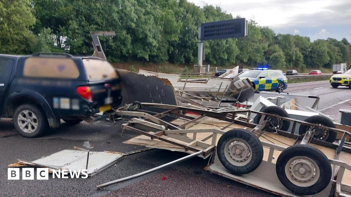

No idea, it was on news last night . Caravan sized and shape of Trailer full of fridges and total destruction of unit, and blockage of motorway. Caught on dashcam, fortunately no injuries.
26,046
9,667
A trailer went off the M6 bridge last night, but seemed a lot bigger than a caravan? https://www.independent.co.uk/news/...all-viaduct-traffic-lorry-crash-b2621554.html
No that was a full size HGV artic. Fortunately the driver had no serious injuries. It wasn’t fully dark so what caused that has to be determined. The one going unstable on the news was a trailer about caravan size and shape but not a caravan. It was loaded with fridges and travelling in Lane 1. But it snaked violently
12,700
4,841
It looks like a fast food trailer, No pun intended. Therefore fridges and worktops .
