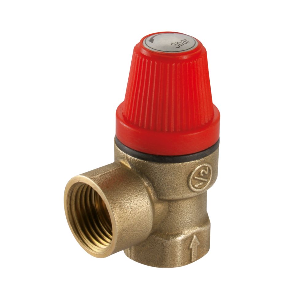

Hi All,
I'm planning to use mains water quite often and I am a bit concerned about pressure reducer failing so I'm thinking about installing a pressure relief valve which would automatically drain if the water pressure exceeds the acceptable level for caravans.
Does such thing exist for caravans, if yes - which one would you recommend?
Thanks!

A simple and cheap solution to protect against the fail of a pressure reducing valve or a sticking float valve would be to add a pressure release valve in the exterior pipework, down stream from the PRV/ Float valve.
Edit, It could also be fitted inside the caravan with an external drain.
