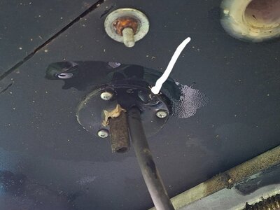

Morning all had trouble with my pump light on control switch not turning off. On inspection this morning underneath there is a dripping coming from this plate (not the pipes) does anybody know what this is and could it be the problem for the pump not turning off.

I don’t know your particular system but I suspect you have found the answer.
Pumps keep going after the tap is turned off , building up pressure to a pre set level, then the pump goes off.
The leak you have pictured is probably the cause and not allowing the pump to build up enough pressure and switching off.
Fix the leak and then re-evaluate.
Tried all day to find any leaks. Been on Google AI and other forums still no wiser. So as its still under warranty taking it back to dealers was hoping it was something I could have solved as it's a 150 mile round trip.
IMO the leak has to be addressed as leaking water can bring serious consequential problems if not cured quite promptly. [Like you I would prefer to fix things than trundle 150 miles, probably twice to take it back and later collect it, however its important you get the leak fixed even if as I suspect it does not relate to your pump running on issue]

Any leakage of the pressurised water causes it to cycle, be that internal leakage back through the pump or out of the system. It would have IMO to be a very significant "leak" to keep the pump running continuously. I don't think your leak is cause enough other that the pump intermittently starting and stopping without a tap being used.

Thanks for taking the time to reply. But I don't have a clue which system it is. Regarding the leak it virtually stopped when the pump was not in use for a couple of hours but as soon as we start to use it again the leak gets worse .🤷‍♂️
As said, pump issue aside its very much in your interest the leak is fixed ASAP, if using the van so adding to the water getting into its structure.

Is that the drain pipe from an internal water tank?
A similar possibility and very common issue in my experience with vans that have seen some use, is if it features a Truma water heater, weeping of that heater's drain down valve. That unlike the tank drain could as the OP states respond to the pump being operated.
OP, this is the sort of item LINK that is the drain down valve that you need to be looking for inside on the van's floor where the external tube is. These "suffer" from leaking caused by particles of water hardness finding their way across the valve seat, so it does not seal properly. Can often be "fixed" by opening and closing it a few times when the boiler is filled with water, so the water draining flushes the offending debris out. There is usually a vent valve associated with that draining looking like this LINK, try opening that as well as doing so significantly increases the draining flow, and could itself be a leak source.
Best investigated with laying under the van viewing you leak with someone inside opening each of these and therefore allowing you to observe if these are associated with that leak.
Similarly you could check Martin's internal tank drain down possibility. In my van that drain down is accessed through the internal tank's "handhole" to a small sink drain down plus in the "sump well" of the tank. Mine is on a chain as used in sinks and as said small, about 1.5 cm in dia.
