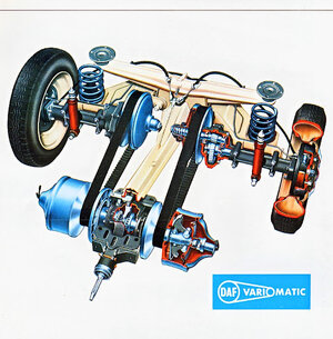

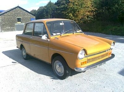

Don't moan about a variable automatic until you've driven one of these, DAF with the "variomatic" transmission!

Didn't Citroen produce a car with a Varimatic gearbox or was it the hydramatic. No clutch, but gears were changed manually.
When I was a kid my mates older brother wrote one of those off after hitting a pile of wet leaves. He managed to roll it, not as in a barrel roll but rather a transverse roll along a wall. He managed to crumple every panel apart from the roof.
His dad was less than pleased especially as it was about a week old.
