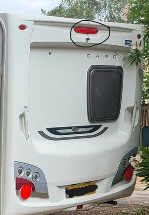

I'm interested in how people have installed a rear view camera to the back of their caravan (Bailey Unicorn, ideally, Madrid). where they got the 12v feed from, how/where the wires went and how the camera was secured to the back. interested in both wireless and wired set-ups (how / where the wires went from caravan to car in wired set-ups)
I'm not interested in the battery-type camera as I need it to connect to my car system, and they're not compatible.
Note, I installed a wireless camera on my previous caravan and got the 12v from the rear lights, feeding the wire through the back of the high level brake light (camera was at the top of the 'van) down through the paneling to the rear lights. can't do that with this van :(bessie rear camera.jpg
