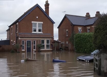

5,786
2,707
Taken from channel 4 news. This is my eldest granddaughters husbands aunties house. They have a grand piano standing in wellies. The Jag will have seen better days.
